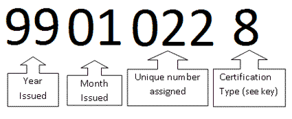

How to interpret the Certification number to determine the level of certification
Web Quick Check
Key
1 = CWI
2 = CAWI eligible for upgrade*
3 = cwi by upgrade*
4 = CAWI
5 = CWI through CWSIP
7 = CWI through Reciprocity
8 = SCWI
E = CWE
G = CWENG
I = SIE/Endorsement
N = CRI
O = CRAWO
R = CWSR
S = CWS
T = CRAWT
Visual Acuity Codes
CB = Color blind
NF = No eye form
NQ = Not qualified
NR = Not required
OB = Without correction/Color blind
OC = Without correction/Color vision
WB = With correction/Color blind
WC = With correction/Color vision
